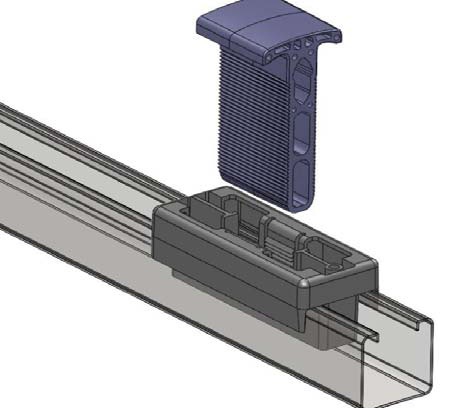

I'd like to ask you for an opinion about the plastic mounting system I've created.
I know much people think plastic is not so reliable as steel or aluminium, but I've performed a couple of tension and ageing tests, and I got good results, that showed me it can stand the pass of 25 years without suffering almost any damage. That made me think if plastic can withstand the same as steel, and is cheaper, why don't I replace steel by plastic?
Then I used a mounting rail made of hot galvanized steel (which is the only steel piece in the system) and developed a plastic clamping system which fits in the mounting rail perfectly, with the main advantage that it doesn't need screws or tools to clamp.
I've attached an image and hope you give me some opinion about that.
Thank you very much. ;)

Re: Opinion about a new mounting system
Beitrag von elhaber » Mo 12. Sep 2011, 10:50
What about inner material stability at the edge of the retension-Arcs, holding the panel down?
What forces can be realized for clamping with the grid?
What dureability against oxidizing and rust is held with the rails in an humidity and sometimes acid industrial atmosphere?
I hope, that you use Carbon-Filled Nylon without weaking-additionals.

Beitrag von elambert » Mo 12. Sep 2011, 12:09
Hi elharber
The last tension test I performed with these clamps showed me it can support a charge of 2400Pa without problems. This material is reinforced with fibers, which improves the material stability, giving it enough hardness to hold panels.
The rails are made of hot galvanized steel, guaranteed by the provider as it'll never oxide. Otherwise, is case of oxidation, it'll keep on working well, as the clamps doesn't oxide because it's made of plastic. There's no reason for it to work differently.
What is your opinion elharber??
Hope I have answered everything alright...
